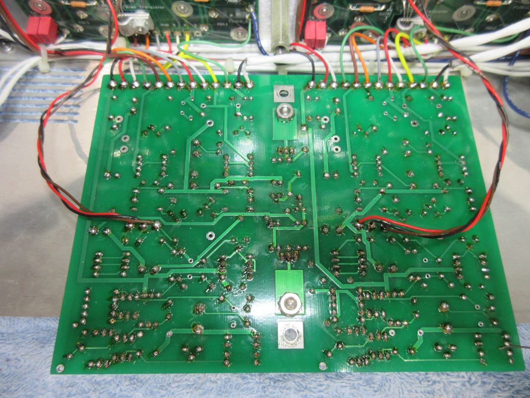

Resoldered the control board, I did not remove the old solder, as I have always fixed dry joints this way, not sure if its the correct procedure. I do have a solder sucker so can remove and re-do if required.
Now the left channel meter pegs instantly when powered on. Can you guys please have a look at this pic and tell me if I have shorted something.
Will check fuses and do those checks that you asked Joe. I should have done those first, was hoping it was a dry joint.
I would clean the board with brush & alcohol. Looks like there is a fair amount of residue flux. Great way to both inspect the board and remove any solder balls.
