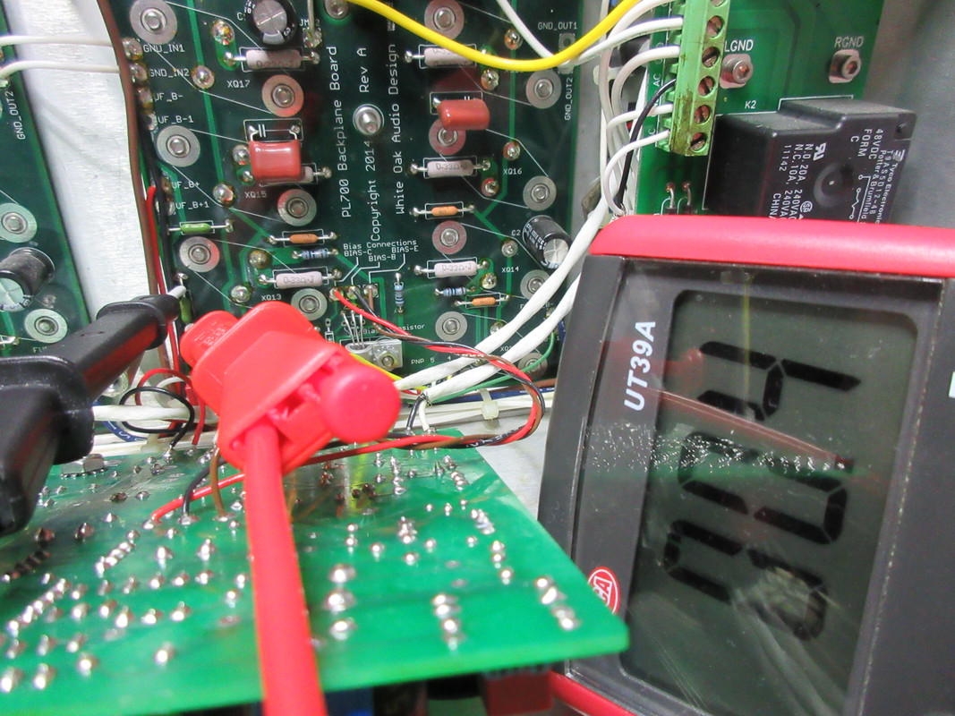

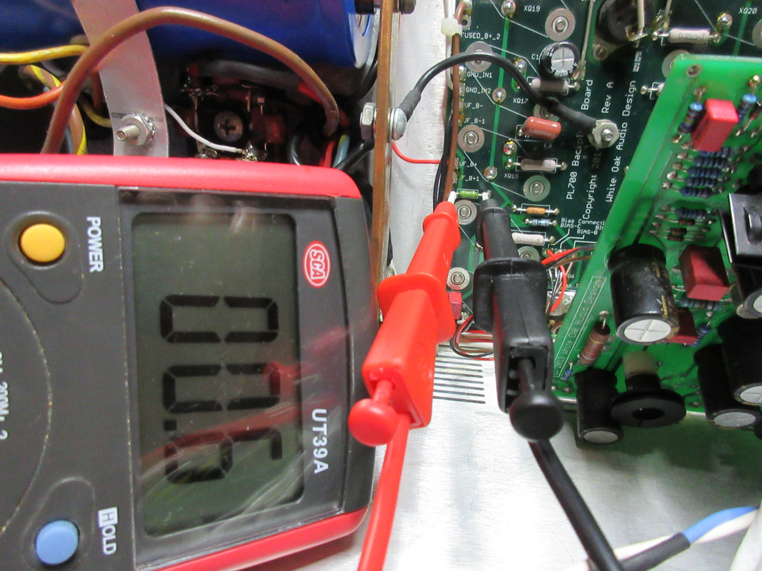

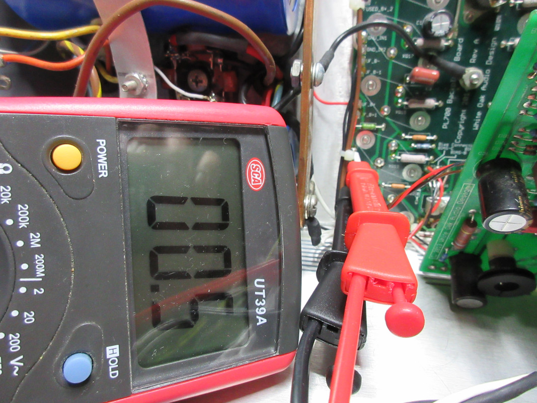

Check Pico's with power off in ohms mode..
In the videos I measured with power off and on.
Or, a 160 Megohm resistor...You have a blown pico..

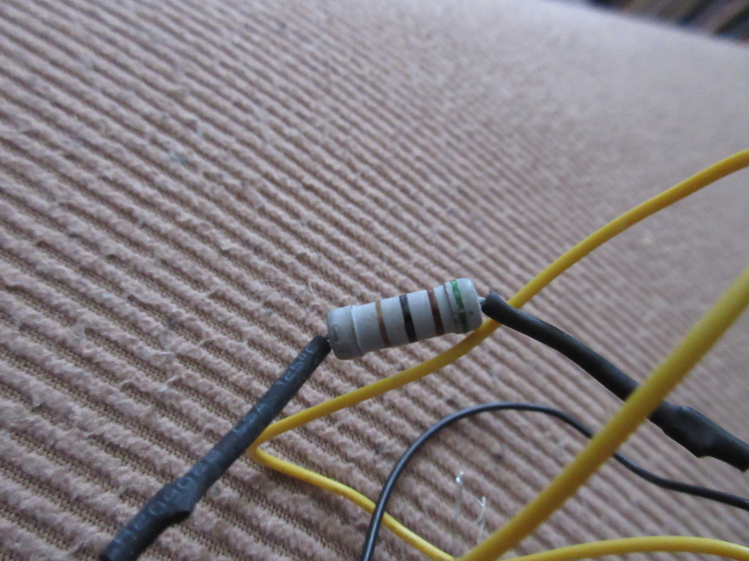

51 ohms, 5% should do OK to check things out further.
Just tack it on top of the existing Pico as Lee suggested Darcy. Till you complete your debug. This is just temporary until you can get a fuse replacement and to continue to see if anything else is wrong or not.Ok, I do have a solder sucker, do you want me to remove the blown pico and solder that resistor I have in its place?
