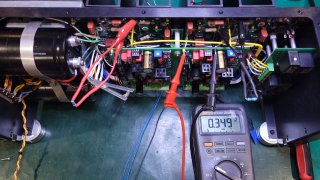

Set the Bias.....Left channel

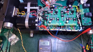

Right channel

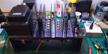

Second row transistors in.....
No shorts DC ground or B+/B- rails and transistor cans to chassis
Reattached ground, powered up.... Relays working, proper voltage, no shorts or blown fuses, no smoke or smell
Rechecked the Bias Left 350, Right 348. Everything's looking good.

Disconnect the chassis ground wire at the bus bar so you can verify the TO-3 drivers are not shorting through the sil-pads after installation. Reattach after all outputs installed.
With chassis tied to ground, you end up measuring across the bulk caps preventing a robust measurement of output driver isolation.
Hey Eric, I do disconnect the DC ground when checking for shorts from the B+/B- rails and the transistors to the chassis. I reattach when powering up to check voltages. Am I doing wrong ?
You are fine.
It was not clear you were disconnecting the chassis ground wire when checking for shorts.

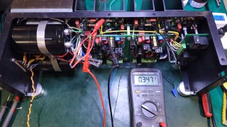

4th row installed no issues......No shorts DC ground or B+/B- rails No shorts transistor cans to chassis,
No blown fuses, no smoke, or smells Proper voltages, checked bias again all good

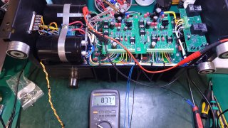

0v at output, pads 11/12 and the +15VL/ -15VL test points.

Voltages..........
