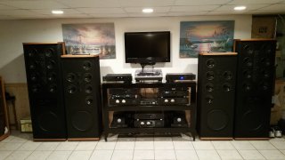

Sealed the cabinets, metal setted the magnets (very important), Dymnat on all the baskets including the passive, installed the Polk RD0-194 tweets.
Here they are in the back of the Tahoe, made a drive to Maryland to get them.
Very important to ship them laying down, you don't want any magnet shift on the mids.
Not too bad.
