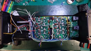

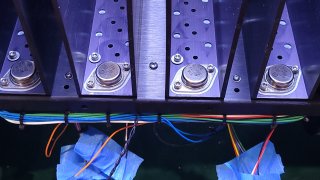

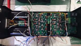

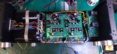

Thanks Eric, I remember now, On the 400 I had to go back and cut the ties to run the Cylon meter wires. (pita)Keep in mind before placing Ty-wraps on the large bundle of wires along the bottom, you need to lace in two Orange wires between the ground bus bar and control board, a ground wire for the Cylon meters, and two wires between the negative rail fuse holder and Cylon meters.
Amen Brother, These WO kits are Awesome.......Nothing but good news there!! If you just follow Joe's instructions it WILL work...bless his heart..
Good job bud...
Thanks Lee, for the kind words. All I can tell you is, I've been learning from the best........ Members here are Awesome..... Thanks GuysI believe your wire discipline is getting g better. Looking at you assembly pics brings a relaxing moment.

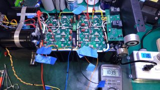

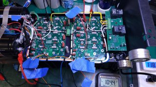

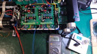

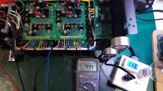

If you have 0V at each output, the relay board should click in.Powered it up, Checked all voltages, no shorts, no blown fuses, no smoke or smells
0V at channel outputs
voltage B+/B- 94 ish
Voltage coming in the house 113,I think TVA's cutting back on the juice.....
question....Is it normal for the relays not to kick in once the control board is installed? They didn't.

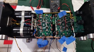

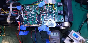

View attachment 88978View attachment 88979
Hi Doug, they are only 500mA fuses so any inadvertent incorrect contact would blow it and you would not even notice. Glad all is well.Hey Joe, It was the left channel UF_B- Fuse. I didn't check them. Dim bulb didn't stay lit. I figured everything was good. I know better now. I replaced the fuse, Fired it up 4 times rechecked each time, everything seems normal. Relays kicking in and 0V at the outputs. B+/B- 94v...What do you think caused it to blow?
