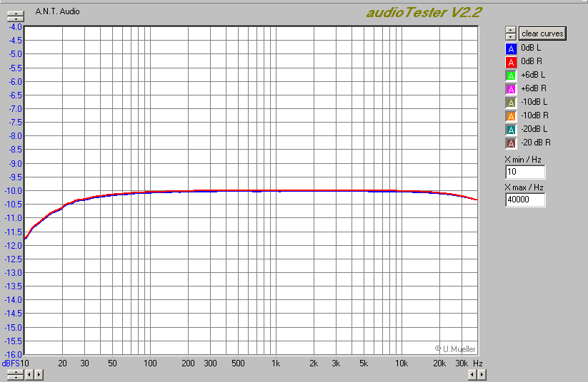

Anyways, the above plot shared by Alex, from an untouched 965 in source mode, shows only about half dB roll-off from 100Hz down to 20Hz and less than half dB roll-off from 20Khz to 40Khz.
While your plots at the beginning of this thread show several dBs of roll-off from about 300Hz down to 20Hz which, IMHO, would be easily noticeable by ears if that measurement plot is what actually happens into your 965 decks.
So, do you also feel that lack of bass by ears or are you only seeing it while measuring?

Crazy. Isn't it?
Level at decks is slightly lower then level at soundcard, it doesn't matter.
Loop at card in/out is a little bit higher (0.5db) over the 800Hz, doesn't matter too.
727 is about 2 db lower up to, say, 800Hz, not a big deal (not huge in any case).
965 is about 13db lower than soundcard loop up to 800Hz and about 11db lower than 727. Not a big deal. It's a disaster! It have to be something that is killing low frequencies. Some capacitor or I don't know what.

Alex SE.... this latter plot of yours is making me thinking about something else...
Don't know if what I am going to say here can apply or not... but I remember such kind of filtering on the bass while experimenting with some external filters added at decks' inputs and outputs to be able to record Cr tapes at 120microseconds (as suggested by Alex/ANT at that other place in the past) when decks used to have different input or output impedances...
I understand that, maybe, impedance mismatches between devices should only change the levels but, hey, if there is some kind of (unwanted) capacitance in the middle then also the response will change and, usually, just with similar shapes as you are showing there in your latest plot, making the impedance mismatches joined with some capacitance acting just like EQ filters.
At this point, it might be interesting to measure the input and output impedances of your soundcard and your decks.
Anyways, it's just a wild guess... because, really, I don't know which your exact problem actually is.
