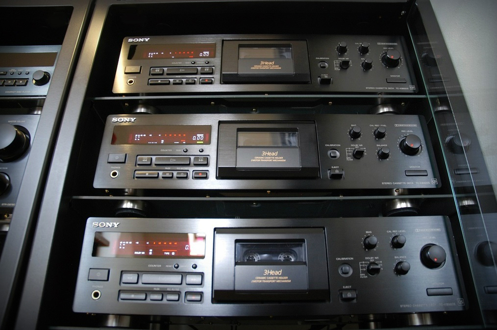

Great to see this thread became a new life.
I've done everthing with cassettedecks, but I've got bored of them at a certain moment...
Nevertheless:
This trio never let me down...
Great to see the thread coming back to life, Miles, but I went a bit off topic... sorry... LOL :D
btw, that makes a total of NINE heads there. :p
