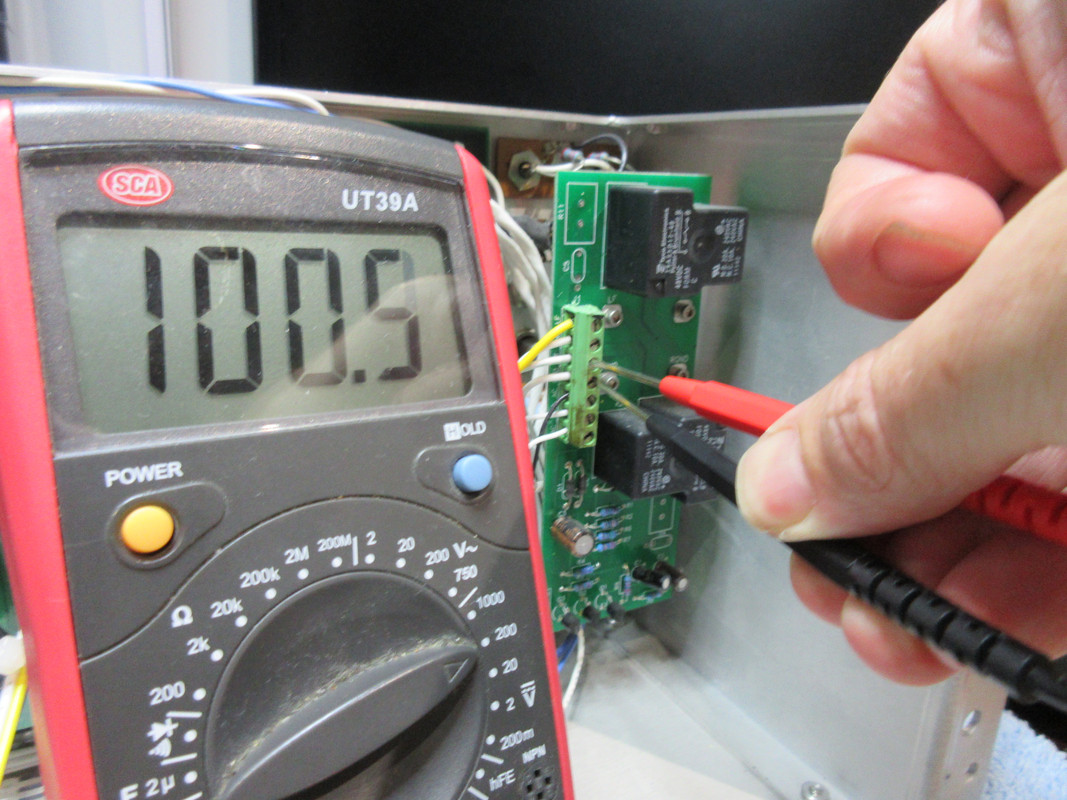

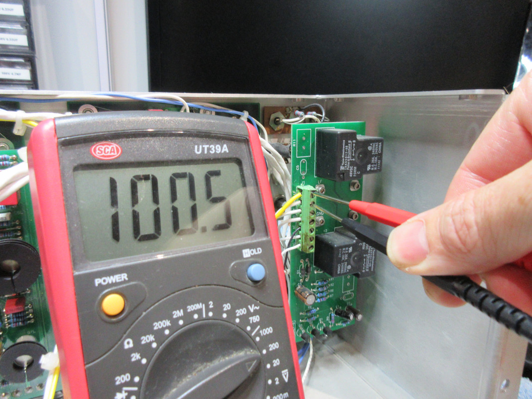

I got just under 100 volts on both
Plus or minus?
Yep, that's right. All rail fuses are good?

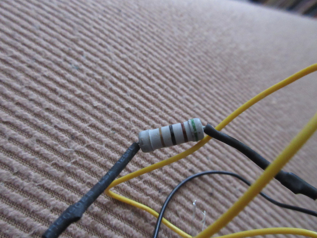

Yeah, that'll work. It's gonna get hot. One end on the plus terminal of the big cap and one end on the minus end of the cap. Check with your meter after about 30 seconds if the resistor doesn't go up in smoke first. Then short the other cap...
Test lead on busbar and other lead on Plus and then minus terminals??
