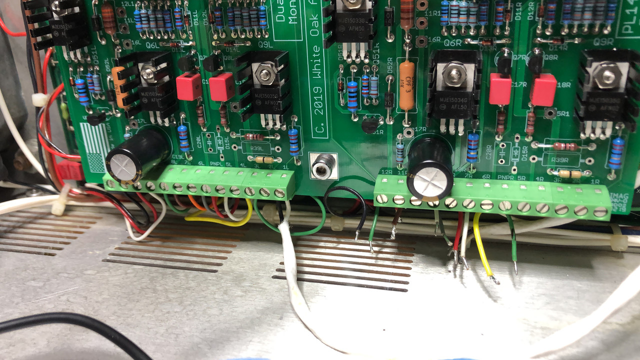

Question, are these parts of the board supposed to be unpopulated?
C20L, D15L, R39L, C20R, D15R, R39R
Yes those are quasi comp components and you have backplanes with full comp setup according to Lee.
Connections are identical in all WOA control board revisions except revA which did not support full comp.
That control board is populated one way to work with full-comp or populated a different way to work with quasi-comp outputs. Having populated or unpopulated components in that area is normal. Lee or Joe no doubt asked what your output configuration is, so you should be good to go with that board as it is.

Pic of Progress, was half way through when I took pic of the board.

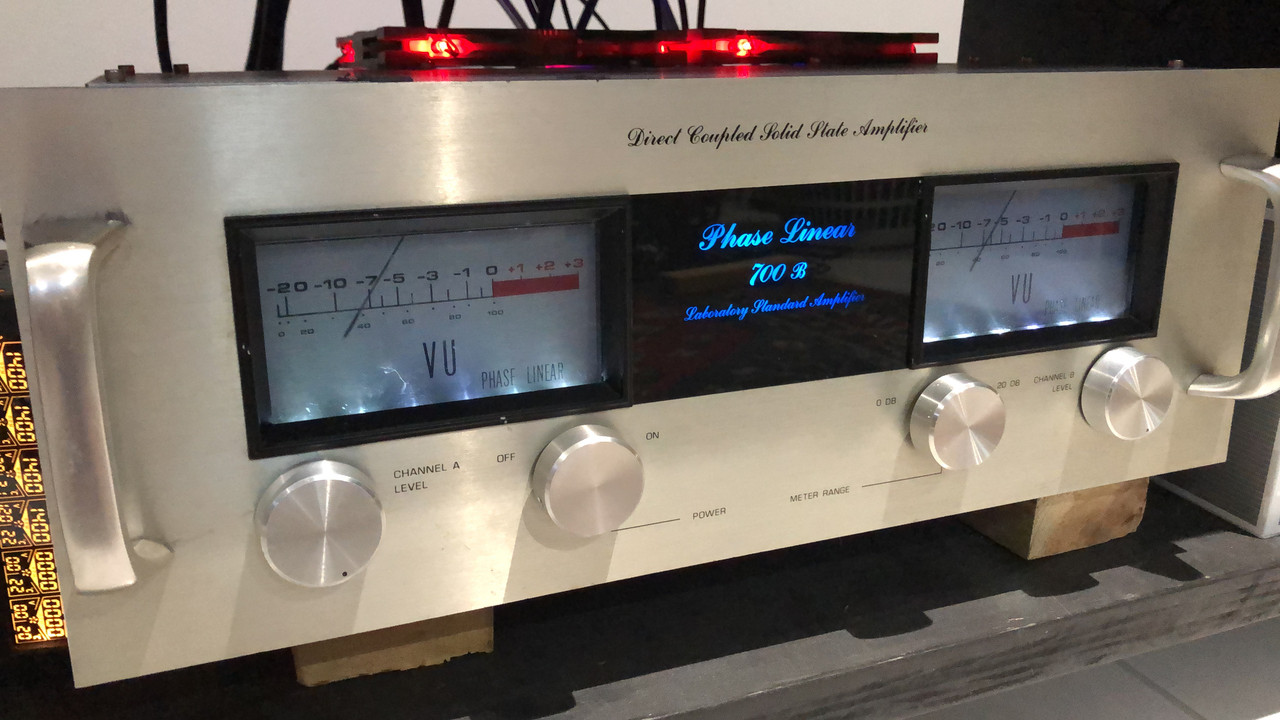

Back in Business. Big Thanks to Lee walking me through it on the phone. Installed the new board, Brought her up on the variac, did some tests, Lee said she is good to go! Running my spare speakers for now then will move on to the Jamos. The revision G1 board sounds so sweet, talk about separation and pure audio goodness! Big thanks to Joe for sending me the board and Lee for doing his part. It has been way too long without a WOPL!

Im half biased today, Im at work and the WOPL is at home, I left the heat on for it though, and my kitty.
