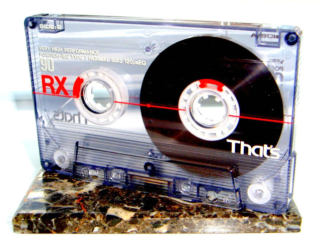

I am a huge fan of That's cassettes. I have never come across this one though.
Thank you to stuartypoorty from Tapeheads for allowing me to use this image.
WHAAAAAT??? :cyclopsani:
Never known about that FM-S... could it be simply a RX with a different name?
Vince recorded one for me, this tape is a beast :thumbright:
Must admit that one came out truly nice and punchy... my Pioneer CT-737mkII loved it!:p
