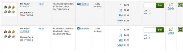

The small form factor RCA jacks are required to fit within the openings in the preamp sheet metal. The 8.0 x 0.75 metric versions fill this bill.
Good question Kyle. High quality from Neutrik-REAN. Others are available (mostly from China) with lower quality. These are what Perry is using presently on his rebuilds.
When you have to get 13 white, and 13 red , it adds up quick. I have to charge an extra $100 to pay for the 26 jacks (over 60 with shipping from Mouser) and cutting and stripping/tinning about 100 wires to get them all installed but the results are great. I guess you don't need my measurement of where to cut the C-1 jack panel to use on the 4000/4000t..... Are you going to advert these on your site Joe?
