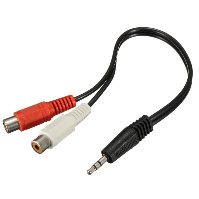

Did you try the audio in/out jacks on the computer and use a mini stereo adapter (two lines in the plug, three is composite audio and video for portable DVD players) to male RCAs (female if you need to extend and I don't ever use a mini-male complete cord because it's cheaper to replace the parts than a whole cable).
