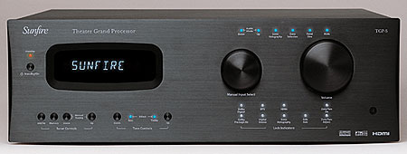

Looking for input from all
  • Output channels: 7.1-channels, single-ended and balanced
  • Decoding: DD, DD EX, ProLogic IIx, DTS, DTS-ES Discrete/Matrix/Neo:6
  • Ins and outs: Six coax and four toslink digital audio, two HDMI, three component, one MM phono input, RS-232, 12V triggers, Ethernet
  • Highlights: HDMI and component switching with transcoding of composite and S-Video to component video, 24/96 A-D and 24/192 D-A conversion, Sonic Holography DSP for enhanced surround sound, backlit programmable remote with LCD screen
i bought this preamp about 8 years ago. Never used it. Now that Al has me going to electronic Crossover and balanced interconnects I have put this into service.
there is not much technical info on this unit. There is actually 11.1 output, all sorts of ambiance channels.
i am attaching the most I’ve found to date for a Theatre Grand lll. There is evolution but from what I’ve found their roots are the same. Most evolution is on the processing side
so far it’s better than I expected.
Want find anything I can on it.

WOW !!!!
Bob Carver Strikes Again!
That unit has whistles and bells on it's whistles and bells!

Maybe to much so.
I’d realy like to get schematic for it and info on who actually built it

Yeah, that thing is the size it is to accommodate the rear side connections!
Internally, I'd expect a pair of boards with a (metric) shit-ton of SMD devices, many ICs.
I mean, look what a friggin' phone can do these days!
