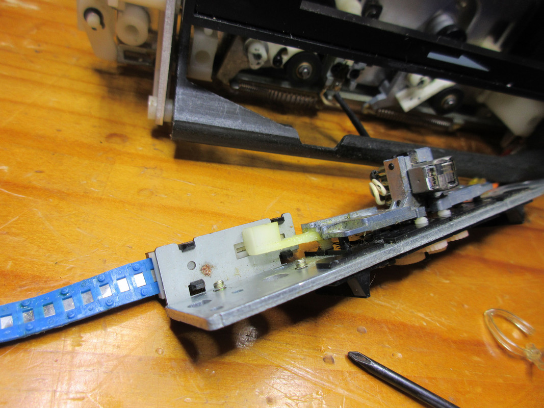

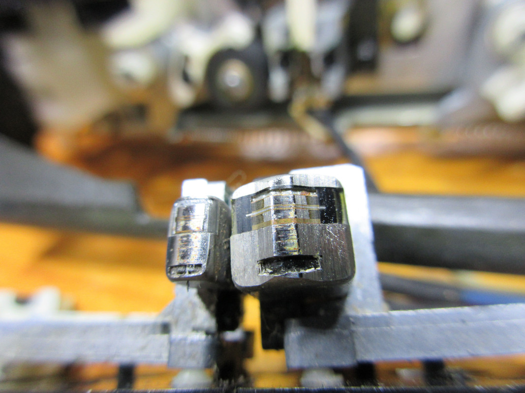

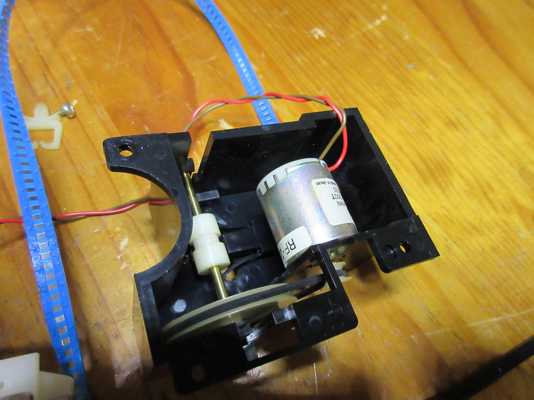

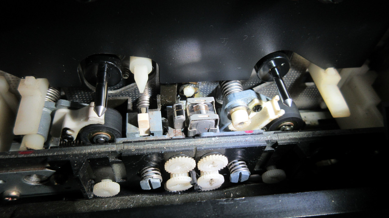

This 670 ZX needed a lot of work. Mechanism was seized due to hardened grease on pinch roller pivot points. To my Horror the heads look terrible, only left channel works, right is dead. Most Likely the head, tested the deck electronics and it has output, just not getting signal from the head. I will try resoldering the leads on the head, if I'm lucky that may make a change but not so sure.
First time I have worked on a ZX deck, took some time to figure out, quite a few frustrating moments, happy ending though, at least got it going.
I contacted the seller and he is going to give me a 660 ZX Parts deck for free which has good heads, not a bad deal at all. Will transplant good heads into the 670.

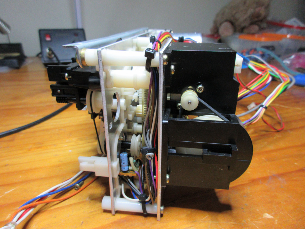

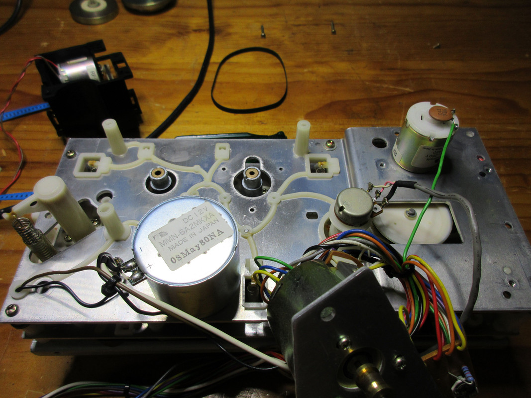

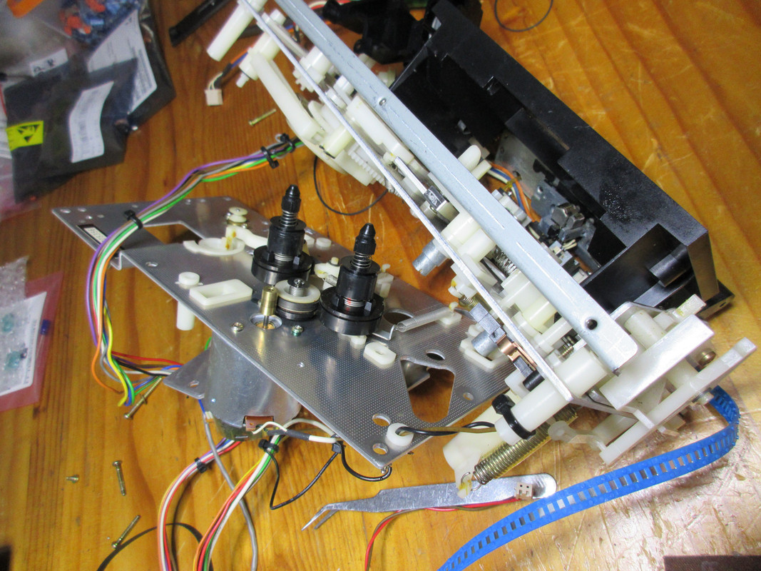

It took quite some time to get this deck right. Heads have been replaced from a Donor 660zx deck, fixed the main sound issue. It was difficult getting the alignment correct after the seized pinch roller arms were removed cleaned and re lubed, but I got there in the end. This unit also seemed fussy with the type of belt used, that had to be right.

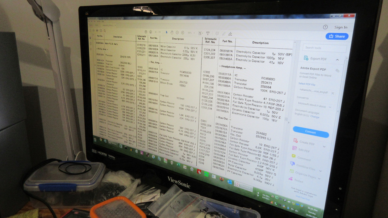

Need to track down a few caps which have strange values. All polyester caps at 100 volts 560pf, 680pf, and 3000pf. Mouser didn't seem to have them. Deck is performing well, however recording is not 100%, I do wonder if its something to do with caps on the switch PCB. Time will tell.

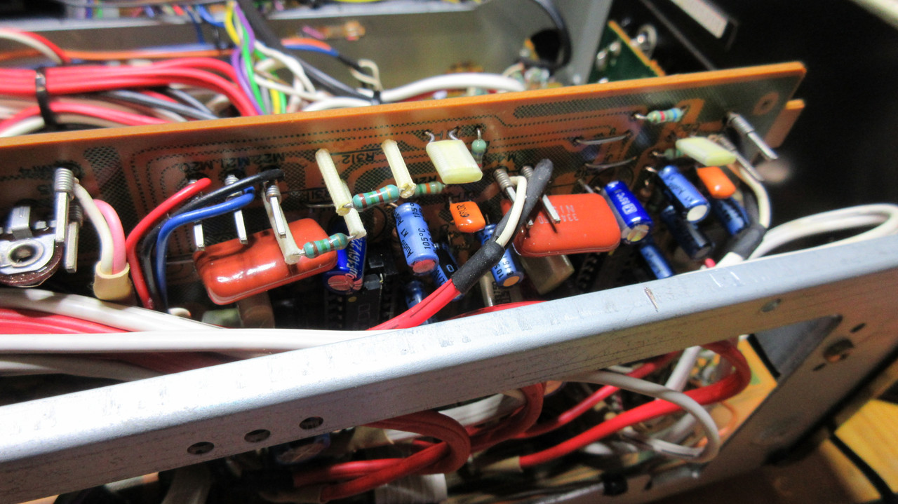

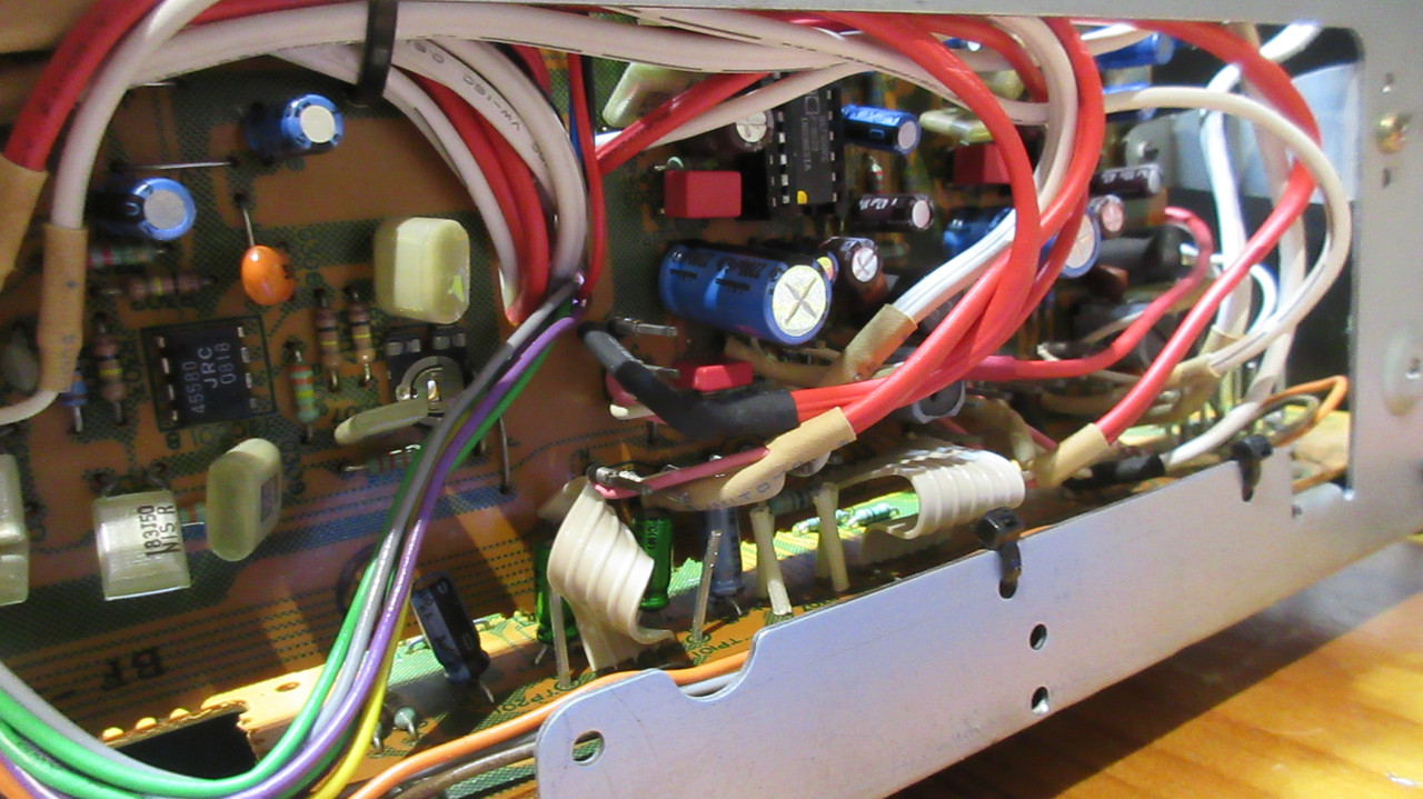

I'm assuming this is the tone generator section:
Jul 30, 2019
97
Belgium
There's a 'tone' generator, which from memory has 1 pp cap, and there's a 'bias' oscillator which has 3 (this seems to vary, sometimes 2). It's the ones on tha bias that cause the most problems. I think you need to look at C316, C321 and C322 (orr close tot those). They're clearly marked in the parts list as PP capacitors. Also, when you remove parts, check the part designation. There were 'updates' over the years that sometimes didn't make it into the manual.
