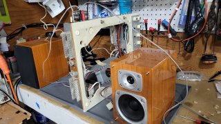

Model 717 will be gutted but the Twenty will be restored because it is a true KLH. 717 was probably some weird experiment with Singer.
717 will get a new TT (Dual), new amps, will try to recap the phono and FM..

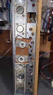

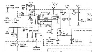

Some more intel on this model. It looks to be a watered down Model 20 in certain ways..
Model 20 has a better PS because it has a class AB amp that can drive a 4ohm speaker (KLH model 20 speaker) as opposed to the 717 which has a basic amp probably is at the max 5 watts.
Model 20 has a bigger transformer and PS caps.
Model 20 uses separate tuning gang caps for AM and FM as opposed to the 717.
Model 20 and 717 use the same Garrard 3000 with adjustable counterweight but the 20 is a 4 speed. Both use the same 4 pole motor.(Probably not much different in this aspect)
Both the tables rest on a spring platform..
The 20 is shielded better...

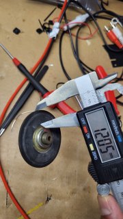

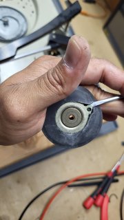

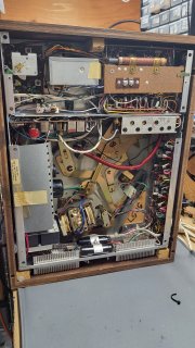

Idler is a weird one..and went rock hard.

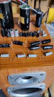

Platter weighs a good bit, everything is well made on the Twenty. Even the coupling caps are also massive..1500uF (the two massive caps bolted on the bottom of the chasis in one of the above pics, seems to be polycaps of some type)
