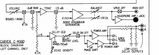

I have a C4000 and it works perfectly after 40 / 45 years .
I made only 3 mods :
- phono 2 input bypassed to have another aux input
- rear speakers screws replaced with bananas for improve connections
- replaced a resistor at the input of delay time unit to avoid distorsion
on rear speakers ( according service manual )
Mods made approx 40 years ago .
I have the first version equipped with power amp for rear speakers and
MM phono 2 input .
There are other versions without power amp and MC phono 2.
I like very much this preamp for its special functions ,
but consider that set up is complicated to obtain best results .
It is the evo of PL 4000 with the introduction of Sonic Hologram
and an improvment of autocorrelator .
Ciao
Marco
