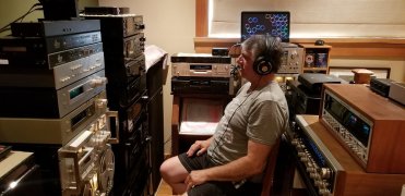

I use a Carver C-9. But in order to get the best desired effect from the processor, requires moving the stereo speakers out from the wall by 3 feet with 3-5 feet separation between the left and right speakers, then the speakers toed in to pinpoint the listening position in the 6-10 foot range, with space behind the listening position. Pretty stringent guidelines to ensure the processor's effectiveness. But, even though I've not followed a single recommended guideline as per the operating manual, it does make a pleasing difference in expanding the sound field and in a few cases I've incorporated the C-9 in the recording process, unbeknownst to the listener who has received my mix tape.
The C-9 is pictured in the left stack atop the two dbx units:
