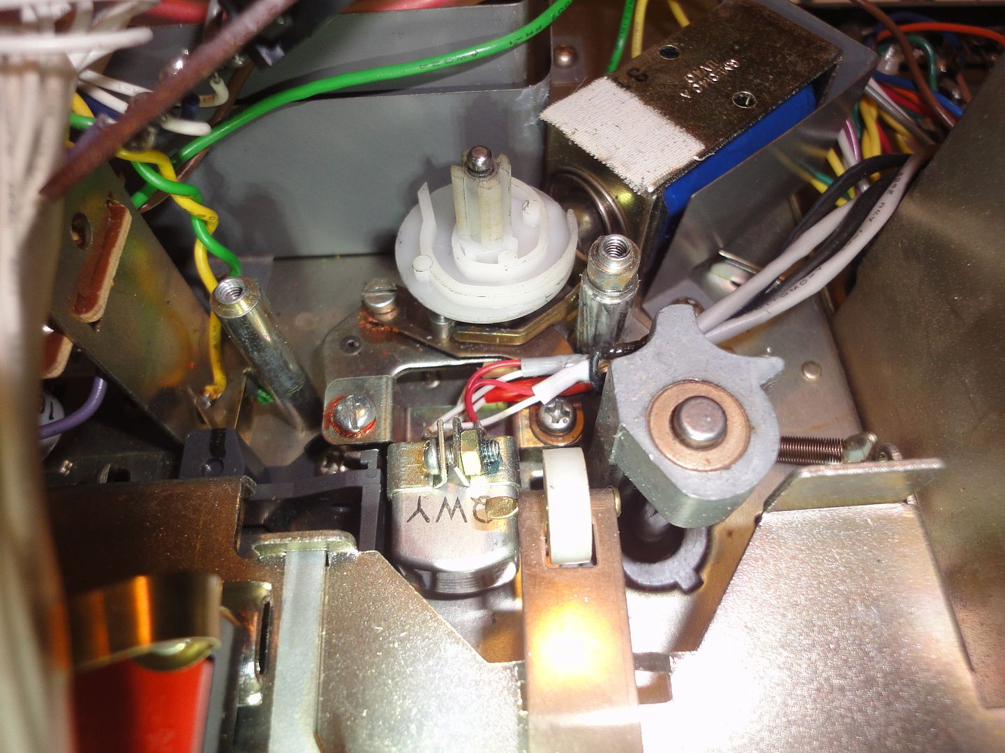

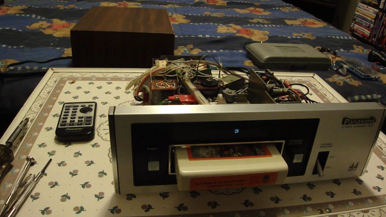

Today, I was helping out a new TH member who has a Panasonic RS-845US 4-channel 8-track deck and needed a few pictures of the engagement mechanism for the head block since his deck had missing parts. I have a model down the line, an RS-844US, so I removed a PCB to expose the head block assembly with associated parts and posted some pictures for him to use as a reference.
After reinstalling the PCB, I plugged in a Herb Albert tape to ensure everything was still working as it was before.
