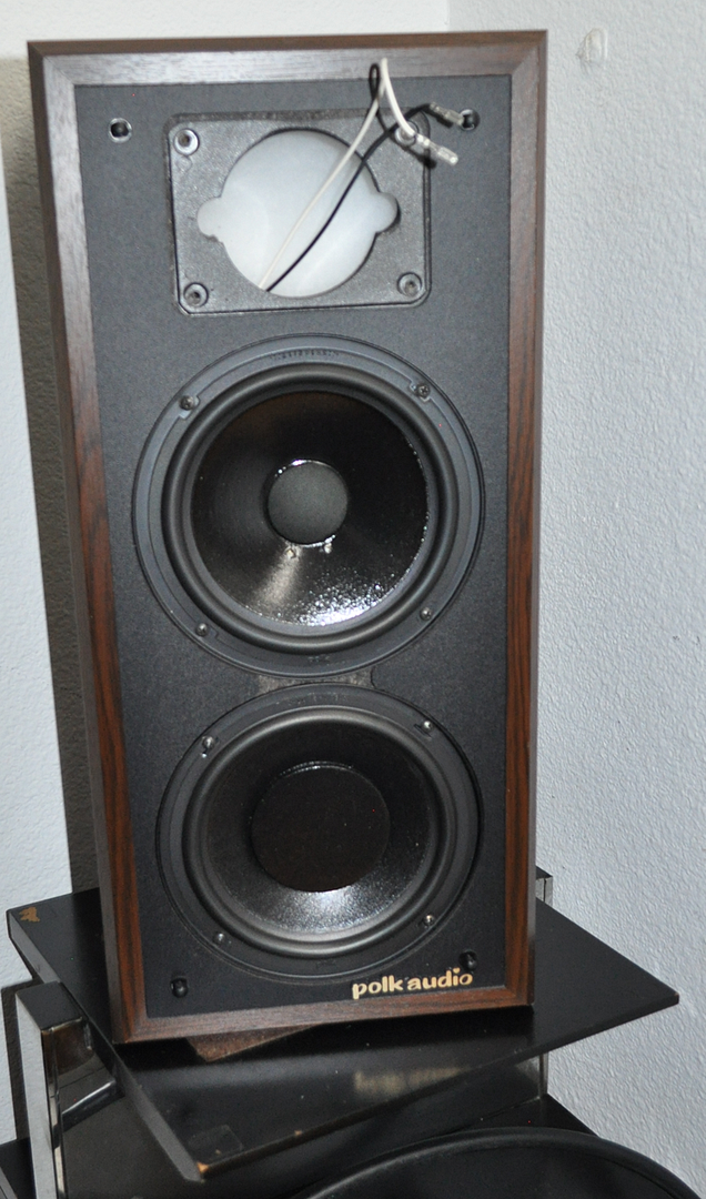

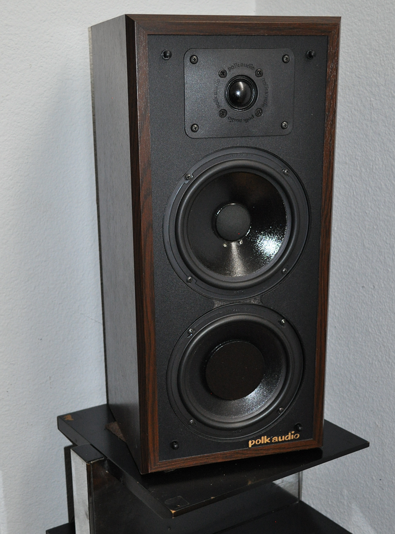

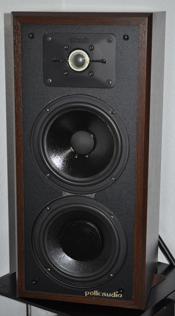

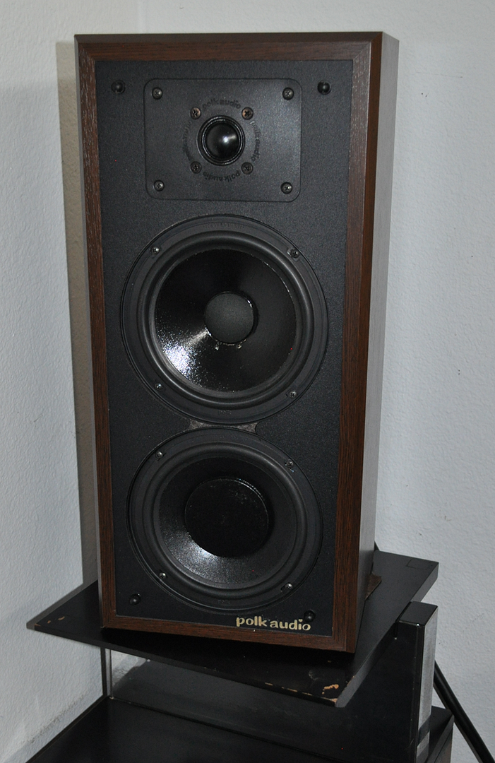

Just Pulled the Trigger on what i hope to be a genuine Upgrade, POLK AUDIO MONITOR SERIES 5 Jr; (11/8/24)
Grabbed them on Good Faith in POLK AUDIO, as my current Stereo pair, POLK R10 Minis, have done nothing less than Impress
since i found them for dirt cheap at a thrift back in mid-2019;
Incredible. just... Incredible...

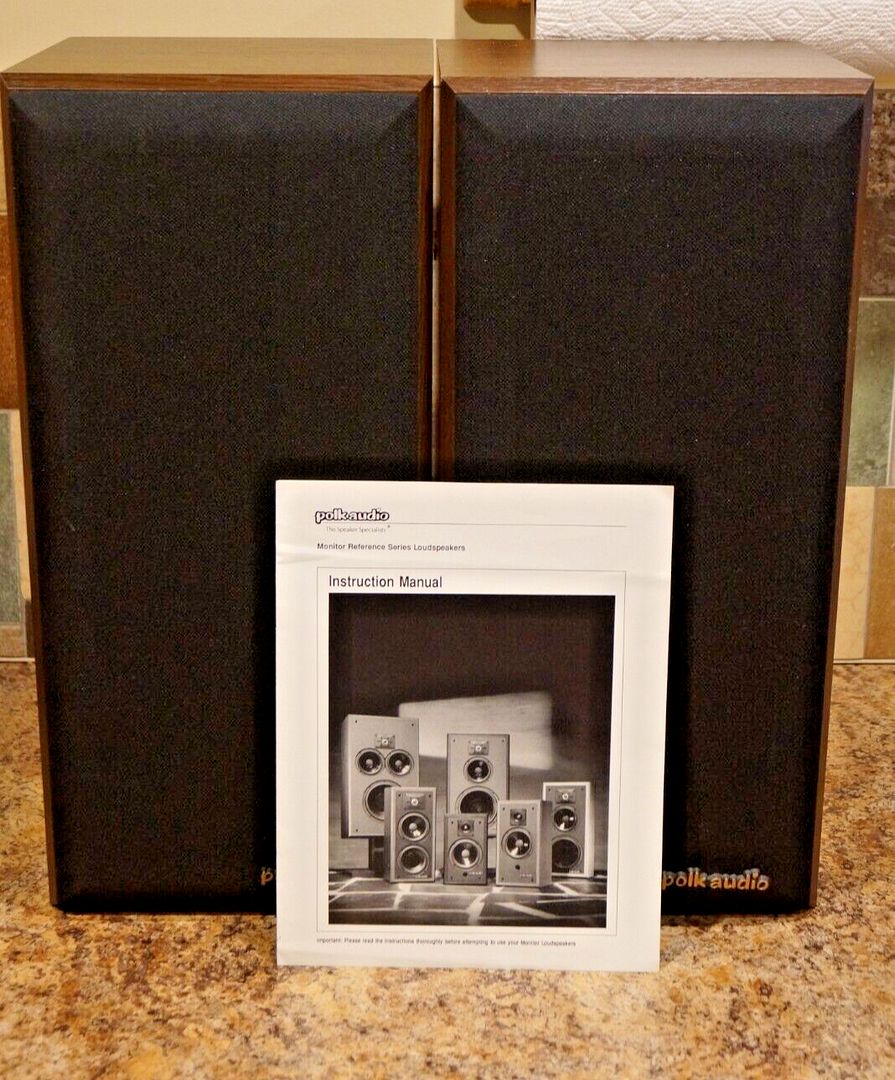

Relocated the aftermarket/repro Logobadges... to more closely reflect the Advert Samples shown on the Owner's Manual;

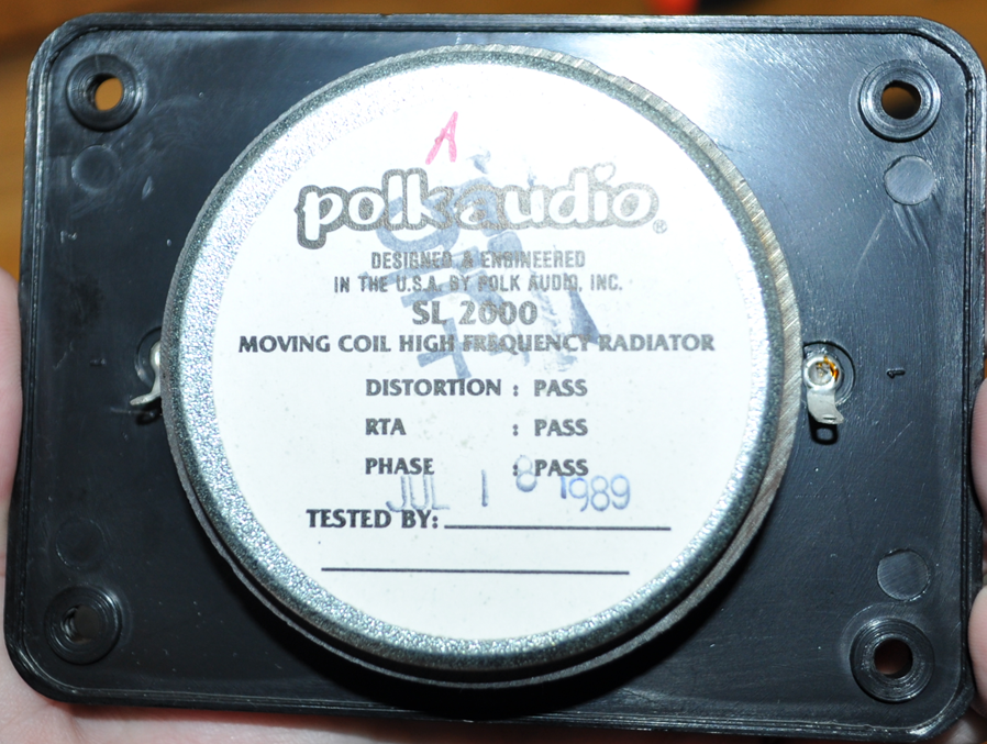

Fans of the MONITOR SERIES product family mainly agree that the stock SL-2000 Silver Dome Tweeter used throughout the line in the 80's is intolerably harsh in tonal character,
and, living with them since yesterday, i am personally inclined to Agree.

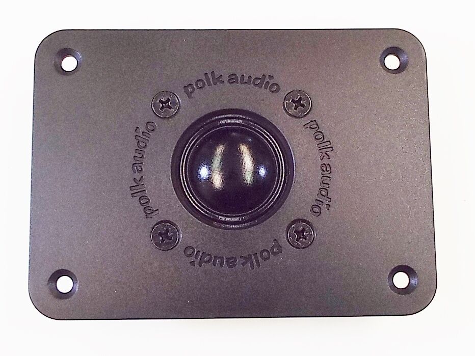

that said, the enthusiasts also agree that the RD0194-1 Silk Dome that POLK shifted to for the 1990's is a 100% improvement; Smooth and Clean as you like.
further; the RD-0194 are direct one-for-one drop-in replacements for the SL-2000 mounted within the M5jr,
so; i now have a pair of OEM RD0194-1 coming my way from an authorized POLK Dealer.
Not exactly Cheap... but for these wonderful speakers, - quite possibly the very best and last i'll ever own - Well Worth Every Last Penny...

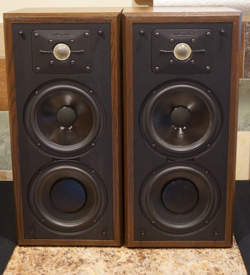

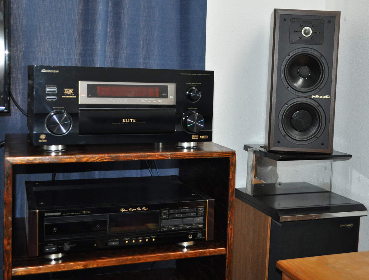

I thought it was a pair of Monitor 5jr+ that I bought from a garage sale last year. I could not pass up the $2 asking price.
During my first two or three years with a large audio retailer, Polk was that company's best selling speaker line. I was particularly fond back then of the 5jr+ and they were usually what I recommended at their price point.
But those $2 garage sale speakers I bought turned out to be Monitor 5B not 5jr+. And by the time I was done, my $2 investment ballooned into nearly $400.
-one woofer was a Radio Shack sustitute so I had to get a correct woofer.
-to prevent magnets slipping, I epoxied both woofer's magnets to their baskets.
-nearly all grille post were broken so had to get a set of those then enlarge the holes in the grille frames so new pegs would fit.
-to cover some small blemishes in the woodgrain vinyl wrap, I had to find a particular shade of wood touchup pen.
-replaced the factory capacitors with Clarity film capacitors
-after being cajoled, replaced the cermet resistor with a Vishay Mills wirewound resistor.
-since I went that far, I too bought the new, current replacement tweeters.

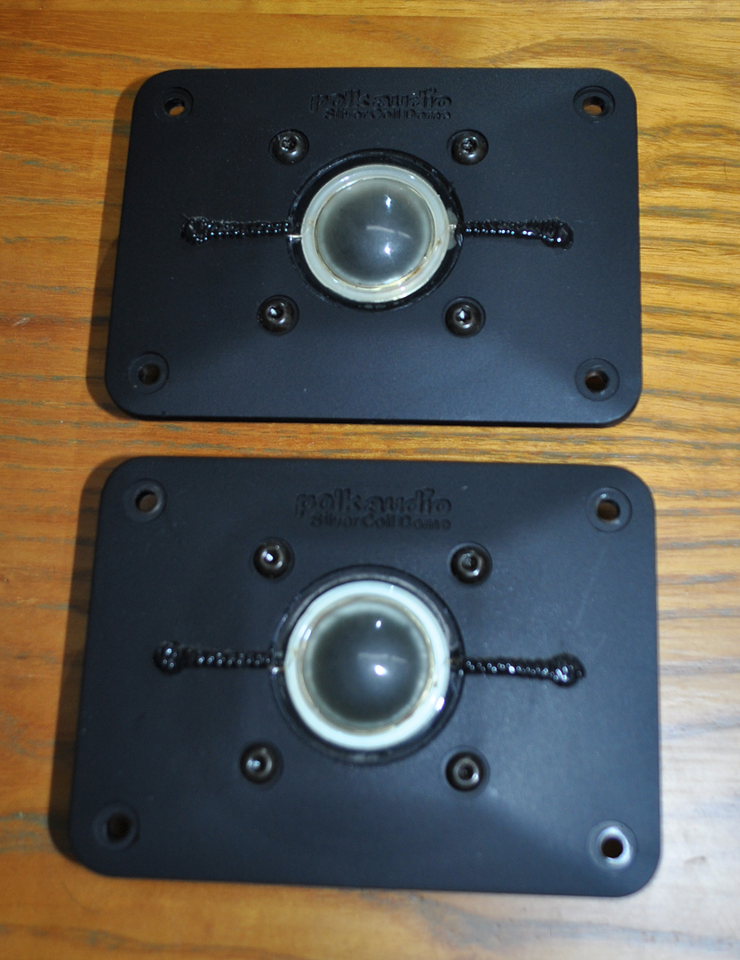

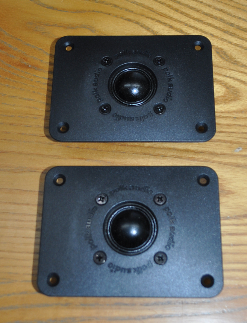

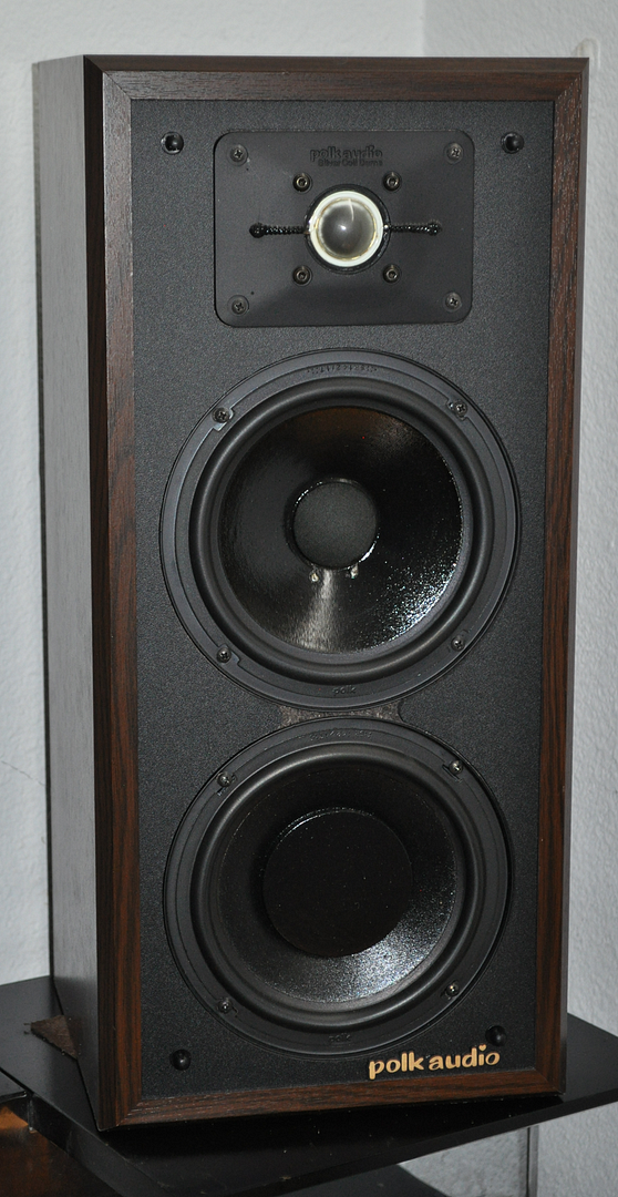

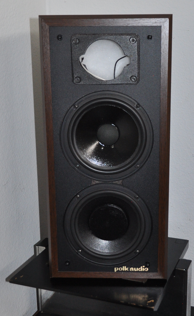

the RD-0194 series Tweeter upgrades i ordered up had gotten held up in transit through the weekend... thanks to USPS.
they came rolling in to my PO today, (11/18/24) and i couldn't pick them up and install them until the Afternoon.
BOY, Do they ever Make a Difference... like a 1000% Improvement, Seriously;
Stock Tweets; SL-2000
New Tweets; RD-0194
Replacement; Drop-in Swap, no Soldering Required
