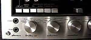

How much room do you have in that mancave of yours? You might want to look for a Marantz 4400 for this experiment, 50 watts times 4 and an uber cool scope to mess with your mind while you listen :ugeek:
Like Nando said, it has a fader to get the sound just right. If you find one with the Dolby decoder on the back, score! :cheers: (it's useless now but, crazy collectors pay big bucks for them :roll: )
http://www.classic-audio.com/marantz/4400.html
