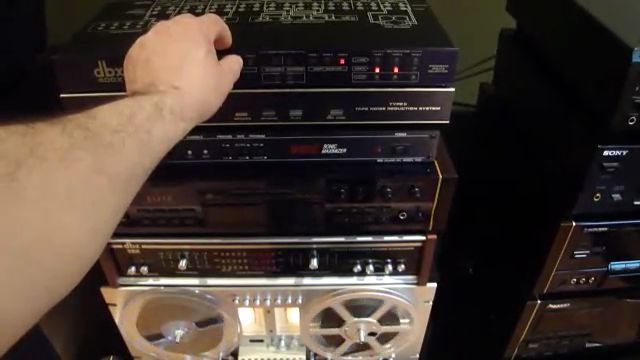

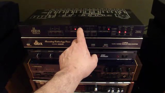

In regards to bias and eq settings for tapes not listed in your deck's operating manual, I use the trial and error method. With the Quantegy 480 I purchased, when it was still being manufactured, I used this method. Record from a CD source, or other digital source. It will make it easier for cueing up later on when you compare between the source and recorded material on your R2R deck. I use my headphones to monitor while recording. Record one song, 4-5 minutes in length, and this will be your trial recording. Use a song you are very familiar with that has good dynamics, a wide range of tones, and strong vocals. Start with the bias and eq settings on your recording deck at the STD positions. Begin recording from your source while listening between Tape and Source to distinguish any difference in sound. Then while still recording, switch the eq setting to non-STD mode. Then a minute later, switch the bias to non-STD mode. A minute later switch the eq to STD mode. You should have gone through four different combination of settings by the completion of the recording and you should write down the four different settings on a pad. Rewind the tape back to the beginning of the song, cue up the CD/digital source you recorded from to the beginning of the song, then begin playing the CD/digital source and R2R at the same. I prefer to play through my stereo speakers on this test playback. Shuttle back and forth between the R2R recording and your source. You might find you prefer a setting that sounds better to you than the source. Check off on your written notes which settings you preferred.
Here's an example of a recording I did a few years back on Quantegy 480 using my Pioneer RT-707. You guess which is the recording made on the RT-707 and which is the source.
Click on image to play video:
