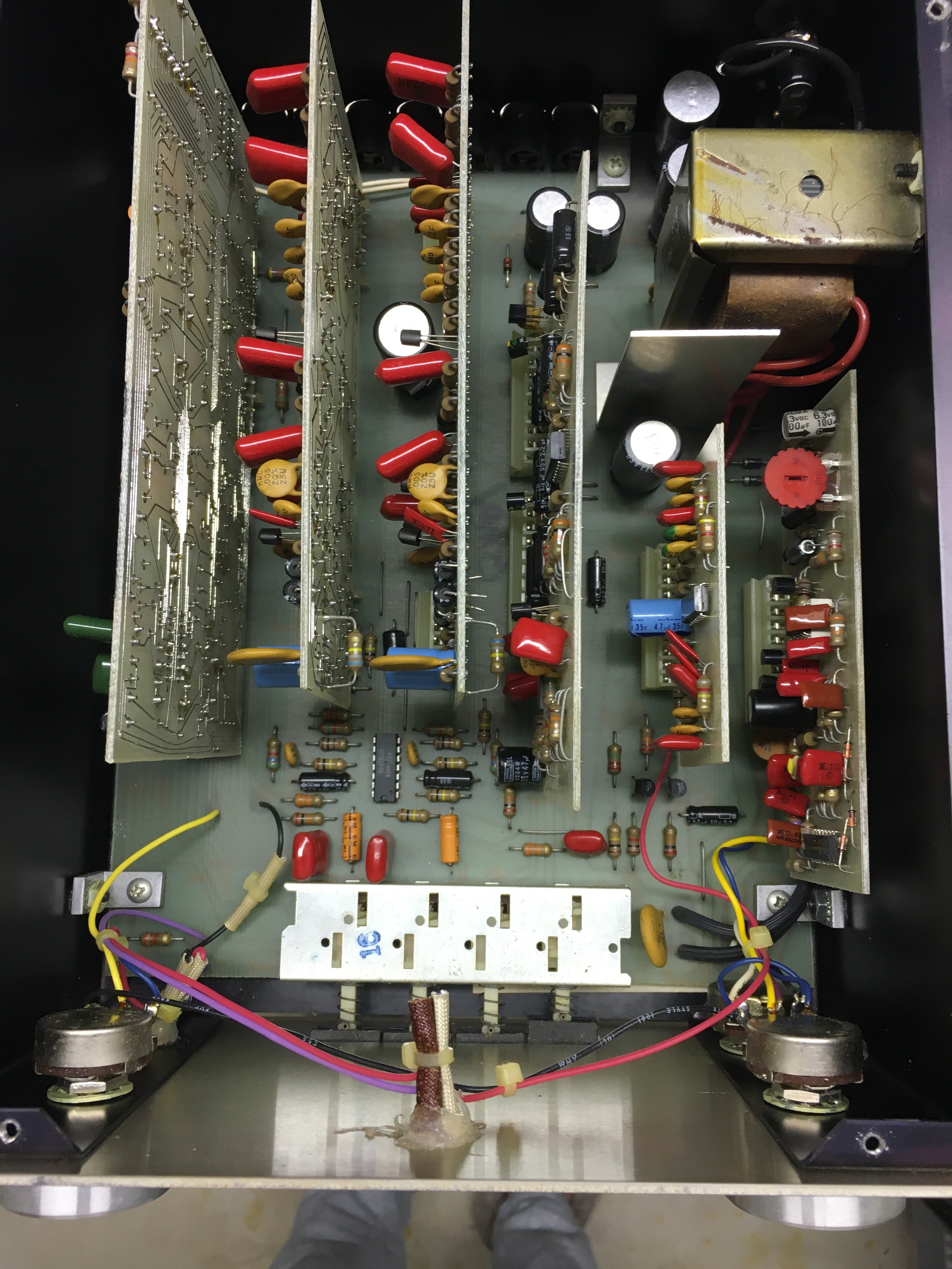

I know nothing about this unit. It was given to me and all I can see is that it powers up. I have never hooked it up or did any testing.

These are great units, boards suffer from the same "itis" all of the PL boards do, (trace liftitis, cold solderitis) but I have one running in one of my systems.
You need a Tape In/Tape Out on your pre, to hook it up correctly. I use it to remove noise (hiss, crackle etc.) from older recordings
on vinyl. For that it works like magic. I have owned mine for almost 40 years, updated it as time allowed, and always called it "the magic noise box".
