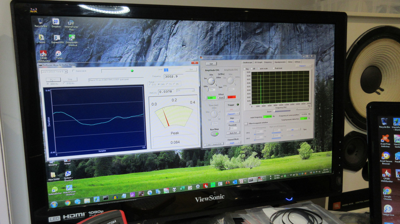

Wow and Flutter is well within spec, tested by Perry using a commercial test tape:
To ensure the deck survived the trip to australia, I also did a wow/flutter test on it upon arrival:
Now you will notice that the test I did has a slightly better result. The reason for this is that I purchased a test tape from Perry, and he recorded the 3khz portion of the tape in his Nakamichi Dragon, which has lower wow and flutter than commercial machines that create test tapes. Please note that I had a range set of 0.1% instead of the 0.5% that Perry set on the gauge, this does not affect the result, just the needle meter position.

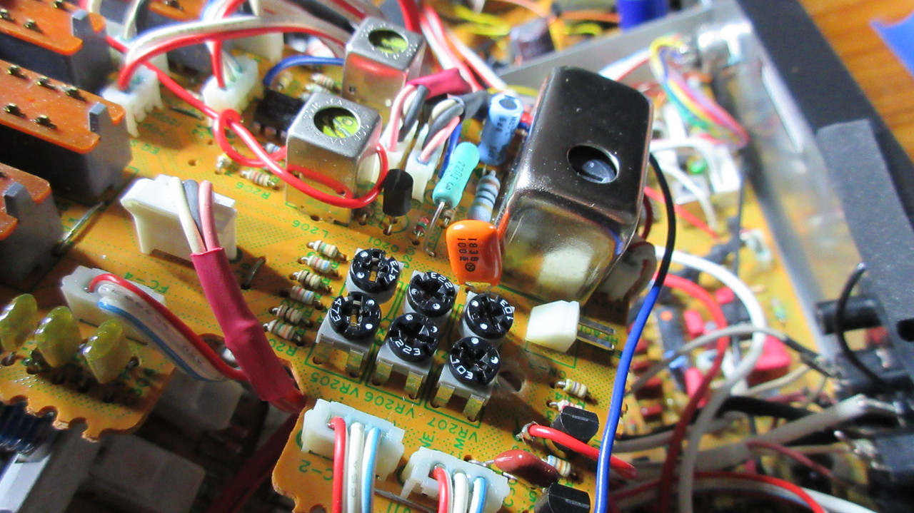

I mentioned TDK SA-X and HX-S to Perry as some of the tapes I would use, and he found a way to make them work just as well with both dolby nr as with TDK SA, this meant moving the default bias position (for chromes) to 9 oclock on the dial, this required internal adjustment. That way I had enough travel to go near fully clockwise (for flat response) on the external bias dial for SA-X and HX-S, as those are both a hot tape. Type II was the only challenge here due to my tape selections. For Ferric and Metal tapes the bias dial is in the neutral position.
