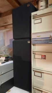

Found the XO-2 yesterday at a thrift store, almost missed them.
The first one was on the top of old furniture, cut angle shape and gold emblem looked familiar, so I chased the second one then found it behind a plasticy 5.1 system.
Instantly recognize the JMR sign, deduct there are XO-2 model then grab them, didn't have to think twice for 60€.
Quick test with the first amp (Aiwa XA-006 from the same place a few times ago) and the first source (Denon DRM-07 cassette deck) that came on hand.
Sounded pretty bad first, thought about dead tweeters or aged capacitors but that was scratchy switches ant pots on the amp.
Replaced by the second amp that came on hand (Sony TA-F60, with Pulse Power Supply), better but still a bit weird.
I redo the connections as the cables that came with the speakers were 'OFC' quality (Oxidized, Focked up, Cracked), turned out the white cable were reversed as it doesn't have a polarity strip.
